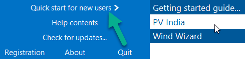

Some of the options in SAM's financial models were designed specifically for India, such as the debt moratorium and return on equity calculation. We also created a "PV India" getting started wizard that assigns cost values in Rupees (although the dollar symbol is still used). You can find that from the Welcome page when you first start SAM:
