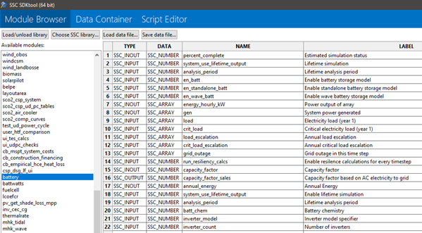

You can find a list of the module input and outputs on the Module Browser tab of SDKtool:
One of the required inputs is 'gen', so you will need to assign it a value before you can run the battery module.

we have a battery analysis using SSC module v209 called from Ruby, I'm trying to upgrade it to v280 - tried to isolate the issue by calling SSC from SDKTool.
It's weird that our current v209 client sends an input parameter named "AC" for the hourly production values (Watts), but I don't see this param in Module Browser, not even for the old v209 version - I see that "ac" is a "pvwatts" module parameter, but the guy who developed this for us used it in this battery module call - is that valid for the old version?
Anyway, added the 'gen' parameter by passing the kW production values 30 times (for some reason, gen is not marked as required in Module Browser), and also added some other required parameters and the simulation runs successfully - thank you!
