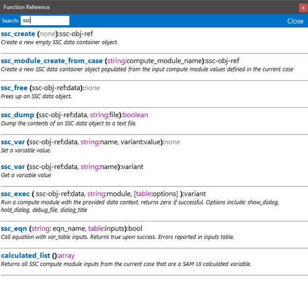

Use SSC objects in LK to store and manipulate SAM inputs. Click Functions in the LK editor and search the function reference for "ssc".
