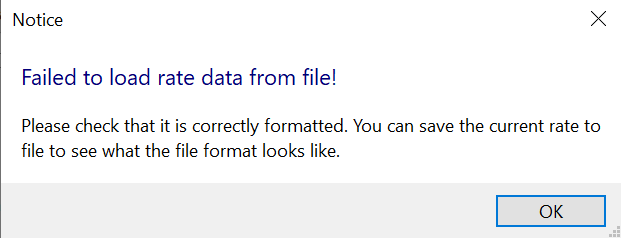

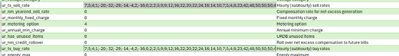

Thank you for your fast answer, you did understand my problem. In the attached files you can find two csv files (one of the basic retail electricity price I firstly saved from SAM , one of the retail electricity price with my modifications . As I opened it in Excel, I attached a screen of the modification I made in Excel and finally the error I have in SAM when I'm trying to load the modified csv .

There are a couple of problems with your modified file:
1. The first row has the text "Column1;Column2;Column3." It should have the data for the 'ur_ec_tou_mat' variable.
2. The columns are separated by semicolons instead of commas.
Attached is a version of your file that should work. You'll need to verify that the data is correct.
I used a good text editor to compare the original file with yours to identify these problems.
If you use a spreadsheet program to edit the file, please make sure to use commas as the column delimiter when you save the file.
