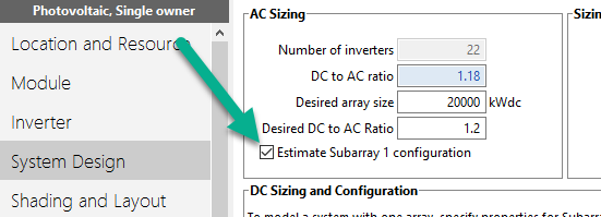

For the Detailed Photovoltaic model, before you run a parametric analysis on Desired DC-AC Ratio (desired_dc_ac_ratio) or Desired Array Size (desired_size), be sure to check Estimate Subarray 1 configuration on the System Design page. Otherwise when you run a parametric simulation, it will appear that changing the DC-AC ratio or system size has no effect on results.
For example, here are results for a parametric simulation on system size without checking the estimate Subarray 1 configuration option, where you can see that the annual energy and net present value do not vary with the desired sytem size:
By adding the System Nameplate DC Rating (nameplate_dc_rating) output to the list, you can see that SAM did not vary the actual size of the system:
Now, if we rerun the parametric simulation after checking Estimate Subarray 1 configuration on the System Design page, we get the results we expected:
