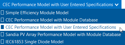

If you are using SAM's detailed photovoltaic model for a photovoltaic system that uses a module or inverter that is not included in SAM's libraries, you can use the CEC Performance Model with User Entered Specifications or Inverter Datasheet options on the Module and Inverter input pages, respectively. Those options allow you to enter data from a manufacturer's data sheet. Behind the scenes, SAM generates the coefficients it needs to model the equipment.
Once you enter the specifications, you can use the Save and Load buttons at the bottom of the input page to save them to a text file to use with other SAM files or to share with your colleagues.
On the Module page, choose CEC Performance Model with User Entered Specifications:
On the Inverter page, choose Inverter Datasheet:

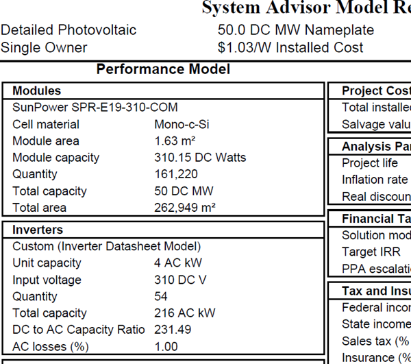

When using the Inverter Database and creating a simulation report, SAM crashes. I have tried this with multiple models. The report works for the other inverter options. How do I fix this?

I have attached the file, it crashes when I try to save the PDF to a location. I think it has to do with the battery system too. The inverter database works individually, and the battery system works individually, however it crashes when used together.
